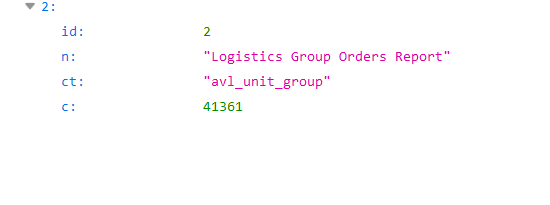

Hi all,
I am trying to find where I can get these information highlighted in red.
https://hst-api.online.stavtrack.com/wialon/ajax. … eport&
    params={
        "reportResourceId":163266,
        "reportTemplateId":10,
        "reportObjectId":34868,
        "reportObjectSecId":0,
        "interval":{
            "from":1357938000,
            "to":1358715599,
            "flags":0
    }&sid=<your_sid>
I tried to query the available reports to check if the  "reportResourceId" and  "reportObjectId" is available but no luck ( kindly see attached file)

Hello. Execute core/search_items with following params:
{"spec":{"itemsType":"avl_resource","propName":"","propValueMask":"","sortType":"","propType":"","or_logic":false},"force":1,"flags":8193,"from":0,"to":0}
Flags are 8193 = 1 | 0x2000
Response will contain items with resources and reports, that are belong to resources:
  "nm": "rual_test",
  "cls": 3,
  "id": 14809663,
  "mu": 0,
  "rep": {
    "1": {
      "id": 1,
      "n": "New report",
      "ct": "avl_unit",
      "c": 51426
Then, reportResourceId = 14809663, reportTemplateId = 1.
reportObjectId is an id of the item, on which report will be executed. In your case (ct: avl_unit_group) is a unit group id, in mine (ct: avl_unit) — unit id. They can be fetched via core/search_items too, with corresponding itemsType:
{"spec":{"itemsType":"avl_unit_group","propName":"","propValueMask":"","sortType":"","propType":"","or_logic":false},"force":1,"flags":1,"from":0,"to":0}
In the response there will be ids for reportObjectId:
  "nm": "New unit group",
  "cls": 5,
  "id": 15083106,
  "mu": 0,
  "u": [
    734418,
    734422
  "uacl": -1
