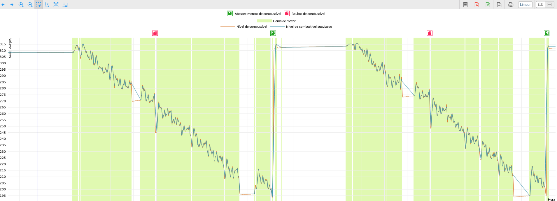

Hello,
In other platform we use there is a possibility to delete fuel fillings and fuel thefts. The reason is simple: vehicles often go up and down hills and the sensor identifies a variation in fuel level. This causes the system to detect a false fuel filling/theft.
In the screenshots (fuel x altitude) I'm sending you can see an example.
If you can't delete these events, the values of the fuel consumption/filled are going to be very wrong, so I'd like to suggest the implementation of this tool.

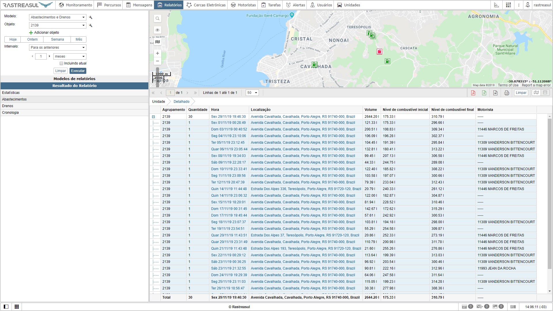

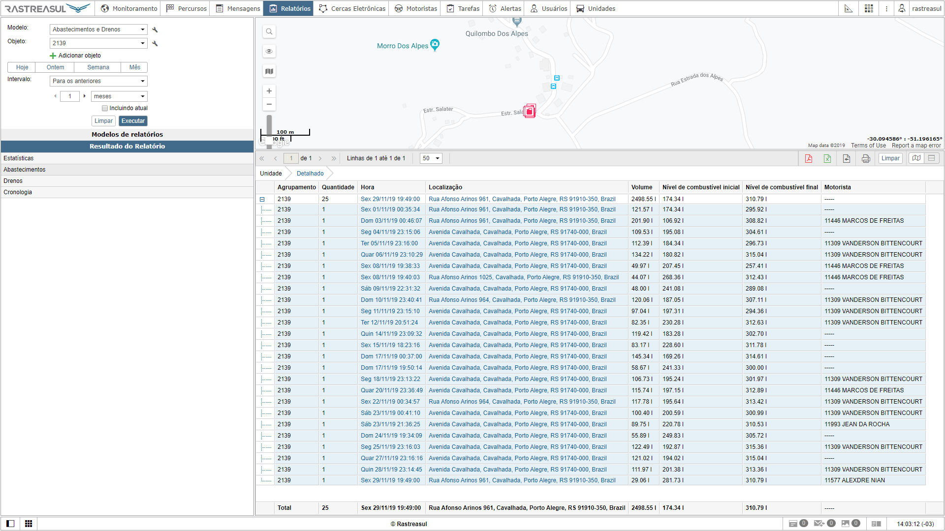

Hello hasan.ahmed , thank you for your help!
I'm sending screenshots of the results.
It helped a lot but didn't solve completly the problem (thefts reduced from 14 to 5 and 5 fillings were reduced, but should be only 4). We live in a place where there is a lot of hills and the vehicles are always going up and down, so I think that the only way to really solve this problem is implementing the tools I wrote before.
Thanks!
Screenshots:
First: without your configurations
Second: with your configurations
1: Fillings
2: Consumed
3: Thefts
