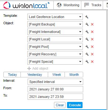

We have a Wialon Local server and are planning to get data from a Wialon Report onto a Google Sheet.
This is because we are already subscribing to Google's services and were trying to explore what we can achieve with Apps Script's Installable Triggers.
Initially we would like to be getting Location Reports every hour or 30 minutes as per our defined geofence names. Please note below screenshot of the Wialon Report.
https://drive.google.com/file/d/1v7vxu9 … sp=sharing
Unfortunately I am also learning Google Apps Script (GAS) so will appreciate any direction on how to achieve this. Currently, I am unable to connect to our Wialon Local from GAS although working on it ... It does support Javascript so have been trying to connect using the sample codes in the Javascript API documentation.
Therefore, I will greatly appreciate any assistance to achieve this.

Regarding the reports, I haven't gotten there yet as I am still trying to come to grips with how to get Apps Script to work with the API.
However, I have already created a report which we are running using the Advanced Reporting module which we purchased. Only thing we need to do is add all the required Item Groups as objects and the report works as we require. I will attach a copy of the report for your reference.

Иконка вложений Freight_Backups_[Freight_Backups]_Last_Geofence_Location_2021-01-27_12-07-54.xlsx 17.34 Кб, файл был скачан 395 раз(а)
